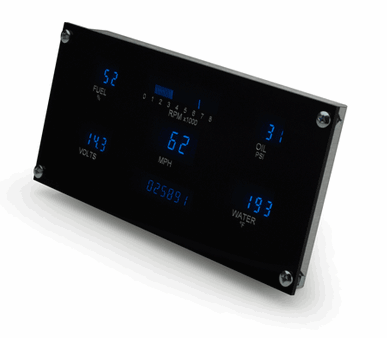

Hola Cers me alegra mucho saber que sigues con tu proyecto GMC la adaptacion seria con un decodificador conversor analogo a digital A/D.
Buscar en E-Bay alguna desarmaduria gringa o alguien que venda el panel del instrumentos listo para conectar.La pregunta es : el panel era analogo o digital ? tienes los codigos en la guantera o alguna otra info ?

Sobre instrumentos ummm mira aca http://www.dakotadigital.com
Click here to return
Digital Instrument System Features
  • Displays included with this instrument system: Speedometer (0-255 MPH or KPH), Tachometer, Oil Pressure, Water Temp, Voltmeter, Fuel Level.
  • Also shown is: Odometer, Trip Odometer, Resettable Service Odometer and Hourmeter.
  • Several performance calculations include: 0-60 MPH (0-100 KPH) timer, ¼ mile timer, ¼ mile speed display, High Speed recall and High RPM recall.
  • Various Indicators can also be displayed such as: Turn Signals, High Beam, Check Engine, Parking Brake, Cruise Control, 4x4 (when equipped), Wait to Start (when equipped).
  • Automatic Transmission gear indicator is also included which will display the full name (ie: Park, Overdrive, etc.) of the current gear. Utilizing the gear position indicator will require the use of a Dakota Digital GSS-2000 sending unit.
  • Dakota Digital instruments systems also include a Demonstration Mode which will cycle the instrument readouts while the vehicle is standing still. This is especially popular while the vehicle is on display at a show, event or simply displaying the instrument system.
  • Full Metric conversions will cycle between MPH or KPH with the press of a button. If full (Celsius & KPH) metric instrument systems are required, please specify upon ordering.
  • Necessary sensors included for oil pressure (1/8” NPT), Water Temp (1/8" with bushings for 1/4", 3/8", 1/2” NPT as well 12mm and 16mm for GM LS applications) and speedometer pulse generator.
  • Fuel level gauge can read either OEM sensor, or any aftermarket style currently available. A universal fuel level sender, SEN-06-1, can be purchased from Dakota Digital if necessary.
  • Fully programmable speedometer for various tire sizes, rear-end gearing combinations, etc.
  • Built-in dimmer will reduce the display intensity as headlights/ parking lights are activated.
  • Fully adjustable warning points alert the user of potential vehicle problems.
  • One-time user settable odometer. This is available only within the first 100 miles of operation. Once exceeded, the mileage can be reset by Dakota Digital at a charge of $20.
** Covered by a Limited Lifetime Warranty!
*** See standard color options Blue or Teal.

Sobre el conversor A/D toma la señal analoga y la convierte en digital , dakota digital tiene algo asi, se usa ese modulo para llevar la informacion al panel digital, el rectangular de color azul.
Nota : para mi es mejor dejarla de fabrica y no hacer adaptaciones que son engorrosas y costosas , prefiero instalar y conectar.
