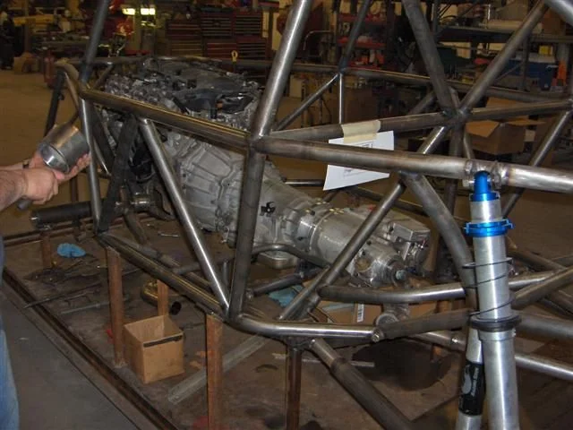

Hola a todos .. me quedé plop
These links work different than hiems in that you would usually have hiems at each end of the link and you would want to lock the hiem shaft to the link, with lock nuts, so as to maintain their original setting. The axle movement and articulation is absorbed in the hiems.
In the use of the twisty, you use a twisty on the link end at the frame attachment point. The other end of the link has a welded fitting that has the eccentric cut (bling, weight, bling), the link is fixed in place by its mount to the axle, but still can still move in its mount. The twisty is fixed in place by its mount to the frame, but can also move in its mount. The link and the twisty do there work as the axle articulates.
Este es el thread .. muy interesante este Buggy ..
http://forum.ih8mud.com/showthread.p...1&page=3&pp=30
Que les parece ..

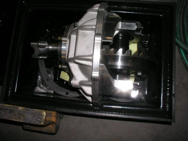

esos son diferenciales portal (de mog)pero esta borrada la parte donde se identifican
Antiguo 29-04-2005, 10:32:54   #5
Empezado por juan andrade
No son de Mog .. son Ford 9" claro que un hibrido con 3rd member de alimunio y otras hartas weas más ..

3rd member hibrido? viejito son de drag racer!
No traen planetarios ni satélites, piñón de ataque y corona nada más, olvídate del bloqueo...
Ese está con spool :wink:

No son de Mog .. son Ford 9" claro que un hibrido con 3rd member de alimunio y otras hartas (%&#@) más ..
Ni las **** idea de como eran los diff de drag racer .. ni idea .. !

El sistema y la contruccion del jeep no son de lo mas novedoso. Porsupuesto que el trabajo es increible.
Pero lejos lo que mas ma llamo la atencion es el tamaño de esos bujes
