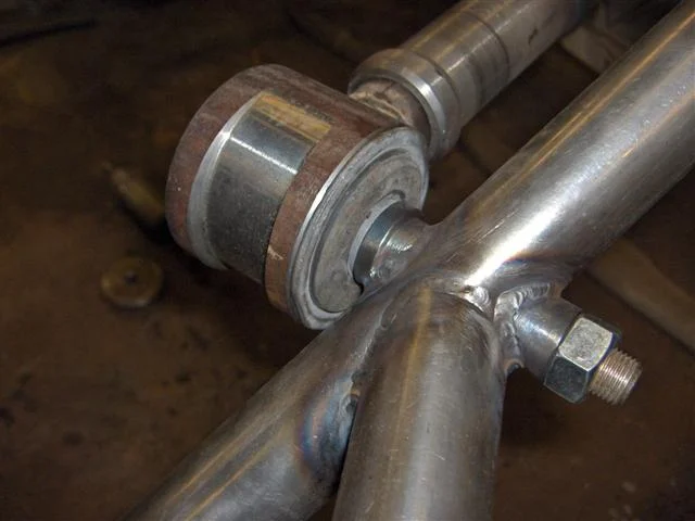

These links work different than hiems in that you would usually have hiems at each end of the link and you would want to lock the hiem shaft to the link, with lock nuts, so as to maintain their original setting. The axle movement and articulation is absorbed in the hiems.
In the use of the twisty, you use a twisty on the link end at the frame attachment point. The other end of the link has a welded fitting that has the eccentric cut (bling, weight, bling), the link is fixed in place by its mount to the axle, but still can still move in its mount. The twisty is fixed in place by its mount to the frame, but can also move in its mount. The link and the twisty do there work as the axle articulates.
Este es el thread .. muy interesante este Buggy ..
http://forum.ih8mud.com/showthread.p...1&page=3&pp=30
http://forum.ih8mud.com/attachment.p...tid=6609&stc=1
http://forum.ih8mud.com/attachment.p...tid=6610&stc=1
Que les parece ..

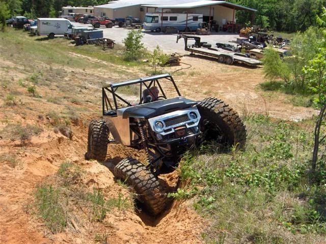

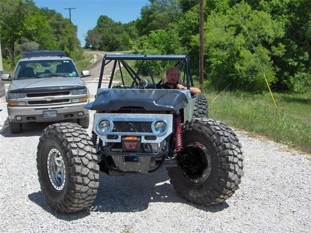

Miren el bello resultado ..
http://forum.ih8mud.com/attachment.p...id=19135&stc=1
Desde 0 impresionante .. :!:
http://forum.ih8mud.com/attachment.p...id=19138&stc=1

cual es la gracia??
que puede doblar mas o algo asi o mayor agarre

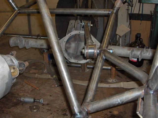

juan andrade 28-04-2005 23:50:41
esos son diferenciales portal (de mog)pero esta borrada la parte donde se identifican :evil:
Tapage 29-04-2005 10:32:54
Empezado por juan andrade
No son de Mog .. son Ford 9" claro que un hibrido con 3rd member de alimunio y otras hartas weas más ..
Roberto Román 29-04-2005 13:32:36
Empezado por Tapage
No son de Mog .. son Ford 9" claro que un hibrido con 3rd member de alimunio y otras hartas (%&#@) más ..
3rd member hibrido? viejito son de drag racer! :shock:
http://forum.ih8mud.com/attachment.p...tid=8406&stc=1
No traen planetarios ni satélites, piñón de ataque y corona nada más, olvídate del bloqueo...
Roland 29-04-2005 13:57:36
Empezado por Roberto Román
Ese está con spool :wink:
Tapage 29-04-2005 18:17:47
Empezado por Tapage
Ni las **** idea de como eran los diff de drag racer .. ni idea .. !
Gonzalo Bravo 06-05-2005 14:15:14
Empezado por honguito 4x4
:shock:
cual es la gracia??
Gracia :?: , te parece poco poder andar con esos neumaticos en un jeep de esa altura :?: Imaginate lo estable que es.-
