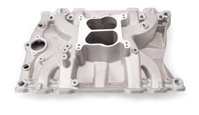

Este camello le hace a mi motor segun catalogo:
Oldsmobile: 1968-76 400-455, dual plane, cast aluminum, Performer, intake manifold.
US$235
This Performer intake manifold is a dual-plane, low-rise design with a 180 degree firing order and patented runner design that you won't find in competitor brands. This design provides torque over a wide rpm range, especially off-idle through mid-range. It also provides improved throttle response over a stock manifold. Ideal for Oldsmobile cars, 4x4 engine swaps, tow vehicles, RVs and boats.
US$235
Facu, algunas partes puedes encontrar, pero compara los precios con Chevy !!! ..... mmmm ...... el Múlt. Adm. Chevy en
http://www.edelbrock.com/automotive/rebate/index.html ..... mucho mas barato.
bye.
