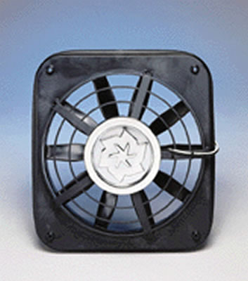

Sip, lo corri 2" y ando con la helice original.
Los gringos usan esta helice con el 1.3/1.6 atras del radiador.
Vendor: Flex-a-lite Consolidated
Product Line: Flex-a-lite Electric Fans
Material: Plastic
Finish: Black
Length: 15 in.
Width: 13 1/2 in.
Height: 2 1/4 in.
Diameter: 12 in.
Cooling that fits almost anywhere.
12 in. single, adjustable thermostat, A/C relay, black, plastic, puller style electric fan
This Flex-A-lite electric fan uses a thin pancake style motor to fit in only 2 1/4 in. of space, allowing easy installation in any car. The single fan is rated at 1,250 cfm and features a lightweight one piece plastic shroud and rigid brackets to ensure a strong installation. Full contact rubber seals prevent unwanted air leakage.
