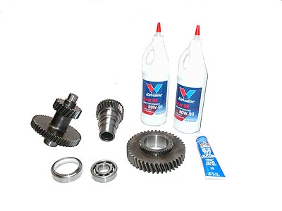

Aquí parece haber una alternativa si tu transfer es la TX-10...no muy barata, pero qué diablos!
EXCLUSIVE !
CALMINI Frontier Rockcrawler Gearset
Finally, a true ROCKCRAWLER transfer case gear set for for the Nissan D22 Frontier 4x4! Our gear set is manufactured in the USA from SAE 8620 alloy bar stock material. For long wear life and operation at high speeds nothing else is acceptable. This gearset provides a final low range reduction of 3.92:1, which is a whopping 93.86% lower than stock! It completely transforms this vehicle's off road crawl capability and enables it to perform much better in heavy off-road use situations. This gearset will fit all Nissan TX-10 transfer cases available in all Nissans worldwide. The complete gearset comes with precision machined counter-gear, input gear, and output gear, billet machine retainer ring and bearing as well as two(2) quarts of Valvoline 80W90 gear oil and Permatex RTV silicone gasket maker.
VEHICLE PART NUMBER PRICE 1998-04 Frontier 4 Cyl NP35100-24 $1295.00 1998-04 Frontier V6 NP35100-30 $1295.00
EXCLUSIVE !
Es cierto... Mandy, gran aporte siempre! son la raja esos piñoncitos pero seria exquisito que tuvieran reducción en Alta, esos solo reducen en "low". He escuchado en foros que alguna vez hicieron una transfer para D22 con reduccion en alta para una en Islandia, pero nunca he podido encontrar información concreta al respecto.
